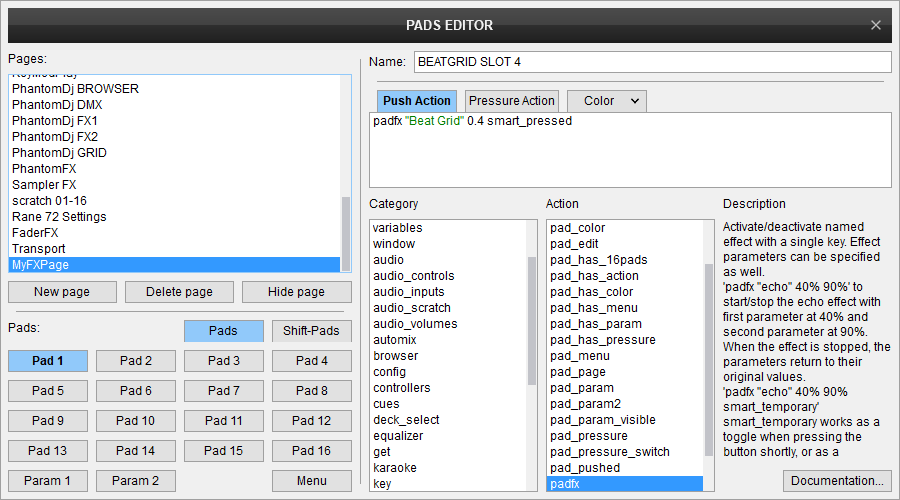

Try this:
<pad1 name="BEATGRID SLOT 4">padfx "Beat Grid" 0.4 smart_pressed</pad1>
<pad2 name="BEATGRID SLOT 5">padfx "Beat Grid" 0.6 smart_pressed</pad2>
Posted Tue 20 Nov 18 @ 8:06 am

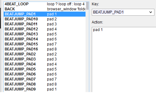

Seem to not work.
Here is how the original mapping looks like:
Posted Tue 20 Nov 18 @ 8:29 pm
You should not mess with the MAPPER like this.
Instead you should create a new pad page of your own, and use the correct scripts for each pad (the above scripts are just an example of how the XML of the pad page would look like)
Finally on DDJ-1000 if you wish you should only remap the PAD_MODE_BEATJUMP button, from pad_page 'Beatjump' to pad_page 'MyNewPageName' and the corresponding led LED_PAD_MODE_BEATJUMP to pad_page 'MyNewPageName' ? color 'violet' : off
