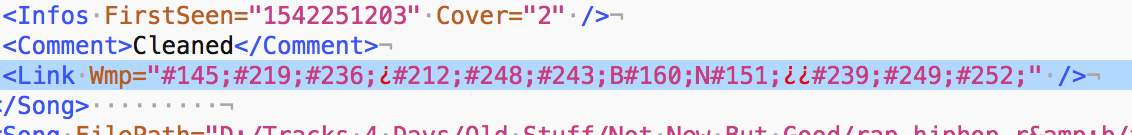

Why is VDJ adding these “upside down question” marks to my database file??
It’s causing big problems with Sound Switch reading my database.
I have them on TeamViewer right now deleting these things but I wanna know what is causing it to happen in the first place??

And the one thing I’ve noticed is it’s only on files that have this “Link” thing added to it.
What is this “Link” thing and how do I get rid of it??

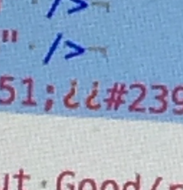

A bit difficult to see any context from that picture...

The upside down question marks, and their only found in lines that start with "LINK Wmp="
They are 100% the problem

It comes from the tag. Can you send one of the files that this occurs with?

Thanks, will be fixed in the next update.
Since VirtualDJ doesn't rewrite the entire database, you would still need to manually remove existing <link Wmp=... /> tags from the database though.
(The link tags with Wmp= can be safely removed)

Question, can I just delete the database file and then rescan all the tracks or is this something that’s in the actual tag of the track??
Posted Fri 16 Nov 18 @ 1:41 pm
It's on the tag.
But once fixed, the new build won't read this part of the tag anymore as VirtualDJ doesn't use it
Posted Fri 16 Nov 18 @ 1:43 pm
If you don't have any cue points or other manually set into that you care about you can indeed delete and rescan with the next build
