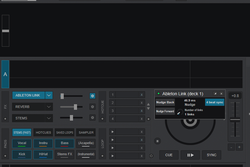

how to map it with my MIDI controller the nudge button so can match faster and easy,
can any one help
and its not work as instant its have to start and restart few time then its work
can any one help
