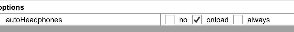

Have you checked the related setting ?
Also keep in mind that if you set manually PFL auto-headphones may stop working for that session until you "pickup" software decision to match the current selection.

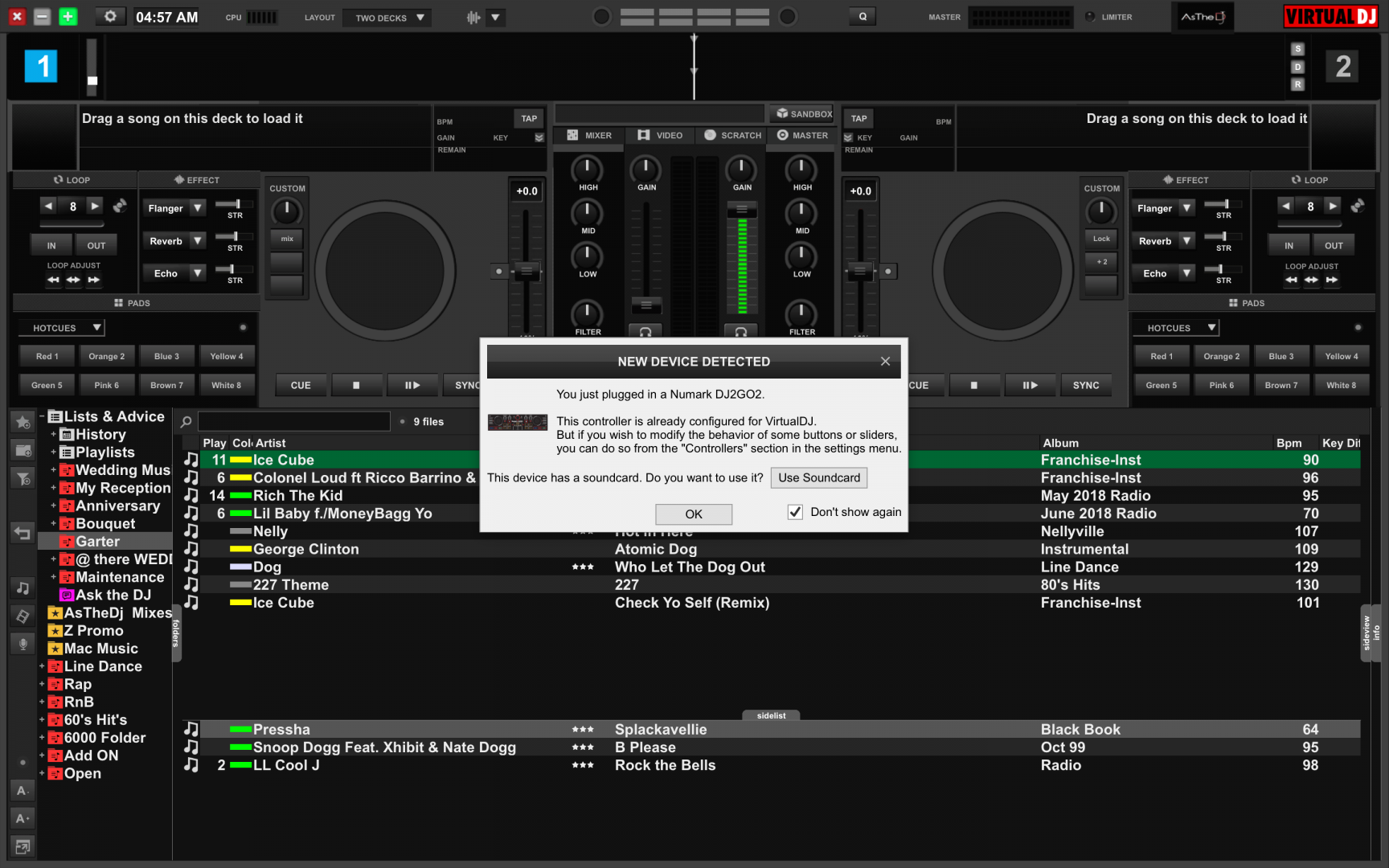

The auto headphone to decks don’t work after I hook up my Dj2go-2 the new update don’t fix it,I’ll been replacing my original setting XML with the old setting XML each time after using the Dj2go-2to make the auto headphone work on my DDj-sx-2.

I assume that every time you plug your DJ2GO2 you get a pop-up window saying "Controller Detected"
Is that correct ?
If yes, please check the "Don't show again" checkbox before you close the Window.
Now DJ2GO2 won't reset your PFL settings anymore
Posted Thu 04 Oct 18 @ 12:01 pm
AsTheDJPRO InfinityMember since 2008
I did check don’t show agin and the PFL stop working after I hook it up,

Ok I got it I had to uncheck PFLonSelect to no 1st then hit ok then close VDj then reopen then check back yes PFLonSelect now it’s working.
