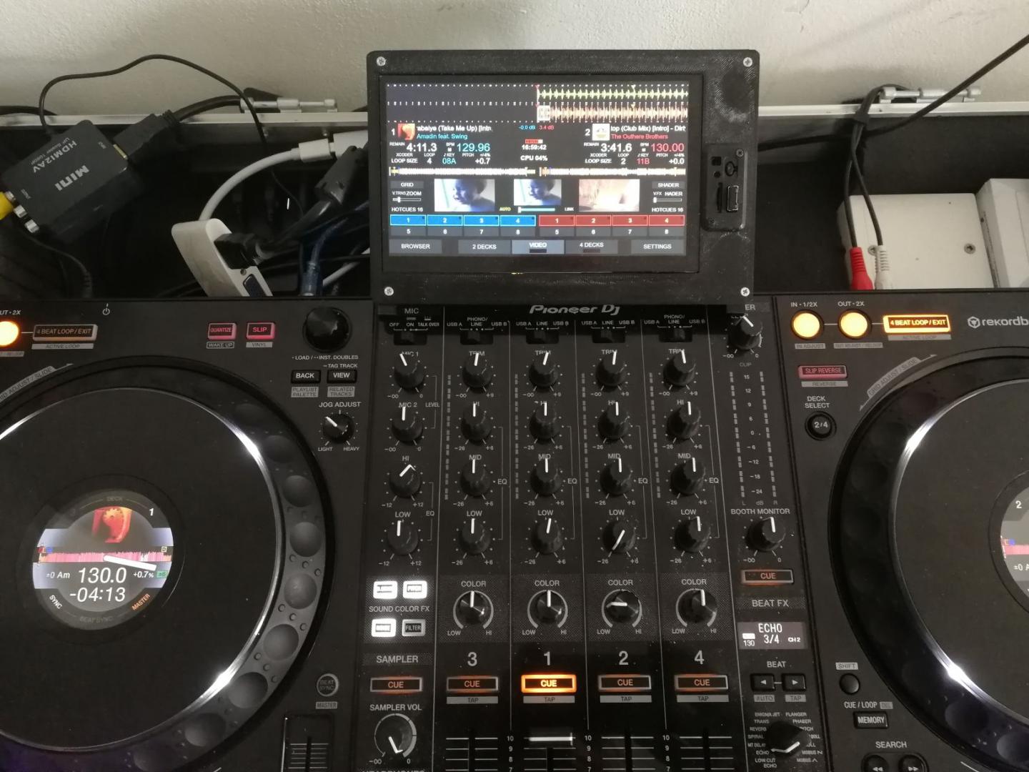

How do I get this skin on my iPad or is it even possible??
Appreciate any info and help

I have a version of it i started modding for my tablet as a regular skin not a remote skin ... if its of any use i am willing to share

I have make an Window from this an invide to my own Skin.
Tha I can use this on an External Monitor.
