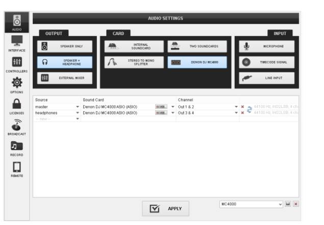

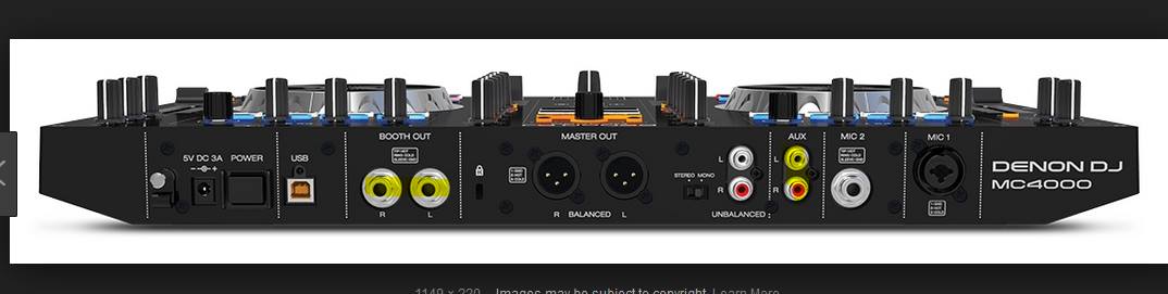

Hi, I have the same controller as well. You probably already know this, but the Aux is an input device on the MC4000, you are best to use the RCA connections (Unbalanced) which are next to the Aux for the output to the sound system.
Also, check the audio output settings on your laptop, which soundcard Windows has set as default. Don't let it use the Denon as default, set it to the internal soundcard, then set the Denon as the output device (which shows you have) within Virtual DJ. Check also the input settings on the Sound / Recording devices, turn off any extras that may have been set under Soud Control Panel under Windows...
Posted Tue 07 Aug 18 @ 11:38 am
Also, I forgot to add, uninstall the ASIO drivers, use the Wasapi (inbuilt) audio drivers to Windows. I had a problem a while ago with the Asio, KRadcliffe, one of the other members on here advised me of this as well, and since then, the audio has been fine and still sounds crisp. So try that.

Thank you for all your suggestions. I am using a MacBook Pro (i believe i removed the ASIO drivers since i had Hercules MK2 for ages)
I followed up the set up with Denon MC4000 that the VDJ8 Manual described. The humming (ground loop) as described is sporadic. Other times has not been an issue.

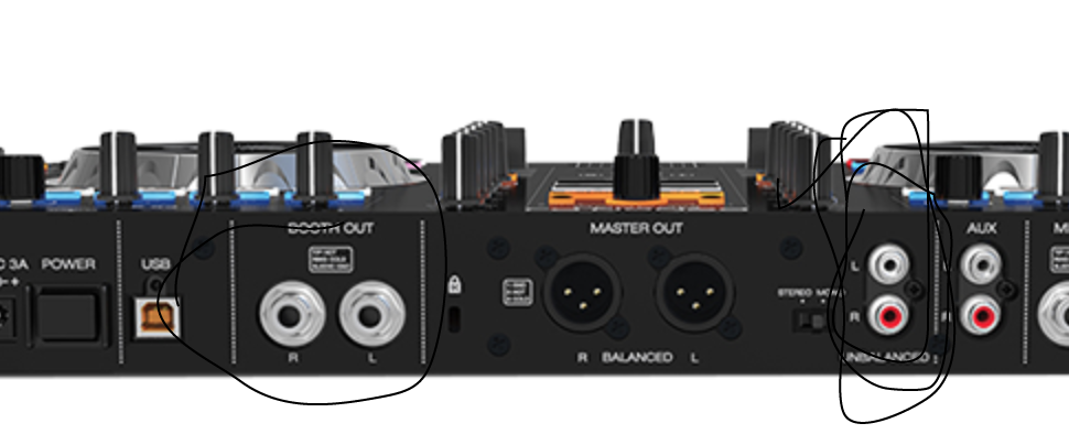

Also i tried using the unbalanced RCA Outputs as shown in the blue circle BUT I get NO SOUND out of them. I got sound of the Booth Out only.
