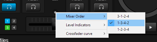

djkrysr wrote :
VDJ does not allow a channel configuration of "1342" on a controller

djkrysrPRO InfinityMember since 2010
OMG thanks for that, i did search the wiki trying to find info on a 1342 deck layout but to no avail and of course because channel 1 doesn't work i tend to use the 2 deck skin and that little widget doesn't appear on that, simple when you know how.
Thanks again :)
