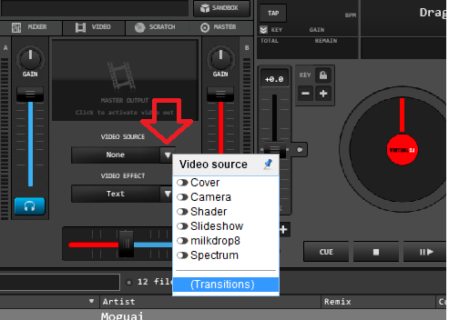

Are you using the default skin? For me, on the default skin, both Adion's advice of loading a video, or Locodog's advice of clicking on "transitions" (see his picture, above), bring up the transitions list. No moving things around or hacks necessary on my computer.
