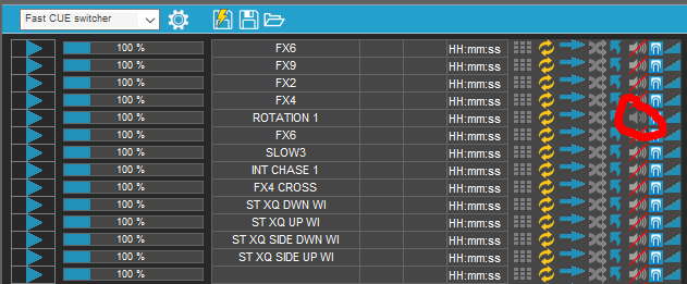

ANY of the 3 solutions to control FS from within VDJ works, but it order to get something to react to sound (beats) you need to enable the corresponding sequence on FS to react on sound by enabling the speaker icon next to it
