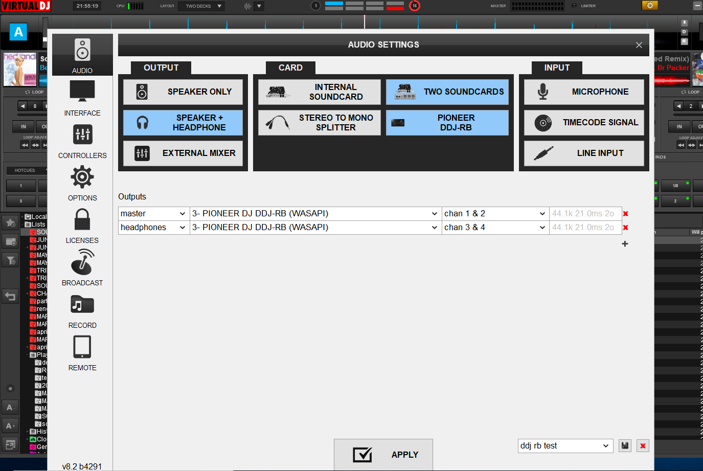

hi heres a snapshot

I've changed the master 1/2 and headphone 3/4 to ddj rb ASIO and all is good finally with the ddj rb headphone cue issue. Deffo had a fault somewhere earlier as I couldn't delete these configs.

why is 2 sound cards selected?
both master and headphones should be on ASIO
