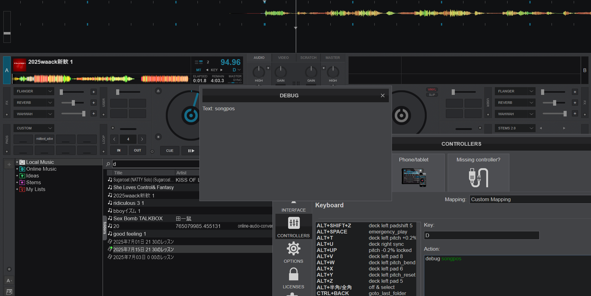

I tried debug songpos to check the current position in VirtualDJ, but it only shows a window with the word "songpos."
Is there a way to show the actual value?
Posted Tue 22 Jul 25 @ 6:05 am
For a start it's song_pos not songpos.
And the syntax for debug is
GetThing & param_cast & debug
Posted Tue 22 Jul 25 @ 6:26 am

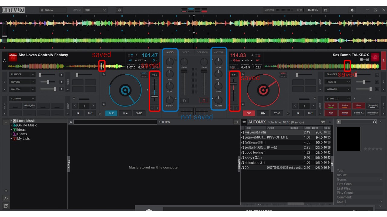

For the past few years, I've been creating long DJ mixes—sometimes lasting up to 10 hours—over the course of several days. When I stop for the day, I pause the mix and take a picture of my screen with my phone so I can remember the exact playback position and settings. The next day, I manually restore the decks to the same position and settings based on the photo. After finishing the full mix, I use video editing software to cut out any silent parts between sessions.
Ideally, I’d like to develop a plugin (or request a feature) that lets me save the current session state—including the playhead position, pitch, and EQ values of both decks—and then resume exactly where I left off the next day.
Ultimately, I’d like to develop a plugin that has this kind of functionality.
Posted Tue 22 Jul 25 @ 7:16 am

Thanks for your opinion and very helpful information!
I was able to save the pitch value and the pause point with save_the_deck. I'm satisfied with just that, but it couldn't save the EQ value. It would be great if the EQ value could also be saved.
Posted Tue 22 Jul 25 @ 7:40 am
The xml file saved by save_deck_set looks like this:
<deckset version="850" date="2025/07/22">
<load deck="1" filepath="xxx.wav" volume="4096" pos="5985252" gain="2048" pitch="4377"/>
<load deck="2" filepath="yyy.mp3" volume="4096" pos="4616170" gain="2048" pitch="3824"/>
</deckset>
I wonder if it is possible to specify high, mid, and low attributes in the load tag by editting this xml file manually.
Posted Tue 22 Jul 25 @ 1:57 pm
Probably not, as part of your save deck set procedure you could write a script to an unused tag and recall it next time round.
Posted Tue 22 Jul 25 @ 2:34 pm
