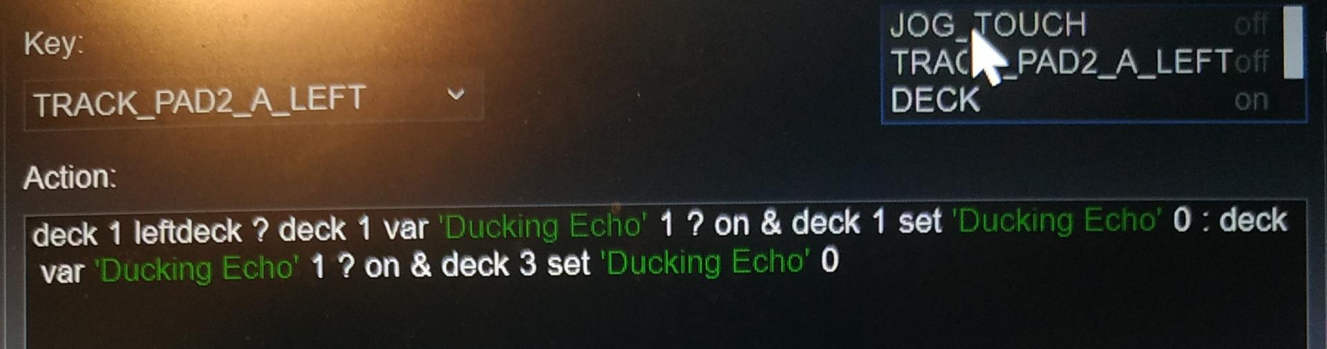

Vci400, using 4 decks, setting Ducking Echo activate. Mapping has to be set for decks 1 and 3 which are the left side. This is what I came up with by truncating the mapping that was used to mimic a post fader effect before the software add a post fader effect. I thought it would work but it doesn't.
@3X just strip it out, as far as I remember work around pffx was a button and a crossfader script, button; delete the mapping. crossfader change it back to just
crossfader.
if you're wary of killing your mapping just make a copy, experimenting with this kind of stuff is risk free.
just to rememder :
leftcross ? deck all leftcross ? xxxx : : rightcross ? deck all rightcross ? xxxx : : xxxx
will do xxxx on all the decks affected to the same crossfader side as calling deck or to the calling deck only if not affected to crossfader

@3X vars have no place with default fx, neither sides/deck really
effect_active 'ducking echo'
post fader fx before official was a patchwork, press this - turn on some fx - trigger a var, var lets the XF script know to use a variation script.
a work around but at the time that made the impossible possible, I don't know if the devs adopted any of my methods or thinking, but I believe my bodge attempt - at least - somewhat encouraged official.
All that said, after poking around new stuff, effect_stems currently isn't post fader, so the method isn't completely dead
Is it possible to work with you on reworking the mapping to fit today's software structure?...
