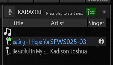

Also, if you UNLOADED the loaded track, look in the Karaoke list and VDJ insert a BLANK Audio (see pic)
