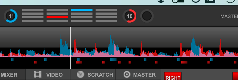

Finally had a bit to mess around with this.
Can't seem to get it right, even using the 1 of 4 command. I have attached a picture of the wave. The red wave is the one I am looking at right now.
The screenshot was captured exactly when the new tempo kicks in. You can see the peak and the 1 marker under it. When I keep playing, the phrase counter still does not reset. There are also some extra beat markers before the next bar kicks in. Any ideas?

Did a few more tracks to check my method. On about half of them, the phrase counter resets. On the other half, no change.
Is there a specific order I need to perform the tasks in? If I sent a new 1 after a beat anchor, will it alter the whole grid, or just the desired portion?
