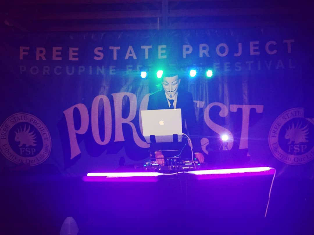

It's a volunteer gig, and I'm super stressed out!
It's an event I have done yearly, but until now it was just this cute little rave in a small tent... Now this year I'm the key event for the evening in a big building!
2016: http://www.djeddie.ml/gallery/porcfest_2016_teen_rave/27448071343_0152f230b7_o.jpg
2017
I've never entertained more than 15 people at most, and my skills are limited to basically mixing between songs and some basic lighting... I need all the advice I can get...

Idk I just worry something is gonna go horribly wrong. I mentioned to the event organizers that I wanted to do my same rave but things changed and all the sudden I am doing a much bigger event.
I guess there's just a lot of stress given I am going to be the big event for the day.

Followup on this:
It went great! It was a total success!
there were no audio failures and only minor user-error issues with the lighting software. I used QLC+ and a USB to DMX converter, which was new to me and took a bit of learning beforehand. Here is a couple video clips and a photo taken of me below:
Edited by AMAHM. YouTube channel led to contact information. Unfortunately, contact information is not allowed by home users.
