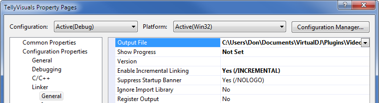

Under properties for the project, what does your linker output file say?

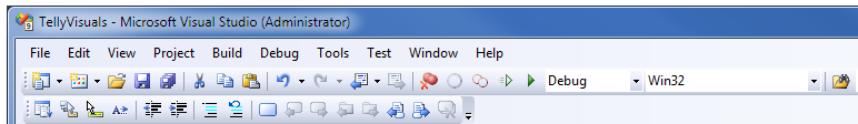

Take a small screen shot of your dev environment so I can look at that like I did here:

That is ok now show me the linker output file as I put in above. Hard code it to be sure it is going to the right place. I mean PDB, DLL, Also under linker and debugging make sure you have it set to create the PDB files To debug your dll you need to have the dll and pdb file in the right place. Nothing else is terribly relevant except the you of course must be running the VDJ.exe which I believe you have done. Does not matter if that has debug symbols in it or not and only matters for the thing you are trying to debug which is your DLL.

No that is fine. Your linker output file path should take care of that but can say for sure with your version 10. I would think that would be the same though. Do what I said and hard code your linker output file path as above. That will either work or at the very least take that out of the picture as a possible problem.
EDIT: Another thing to do is to simply look for the PDB file and DLL and make sure they are where you expect them to be. This should be automated but if you continue to have a problem then simple put them in the right place.
EDIT2: None of it should be the path of the VDJ.exe except the command line path.. The thing that has to run. The other paths are .../Plugins/... (in your case autostart) which is where your plugin is going to run from.
