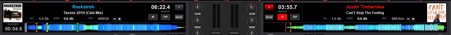

How can i change the postion of the scratchwave of Deck 2 only?

As you can see it is okay on Deck 1. But on the Deck 2 I want the songposition on the left side and the Elapsed time on the right side. The size is also okay on Deck 2, but i want to change the position.

So you want the right deck to be a mirror image of the left deck?

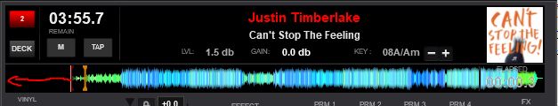

I now see from the close up image that everything else is in place - only the waveform needs to be moved left.

Skin is the the Thing, i want to modify it for my own use only. Yes only the waveform needs to be moved left. That was my problem that there where no x and y co-ordinates in the code. I have delete it and set it manualy, that works fine for me.
