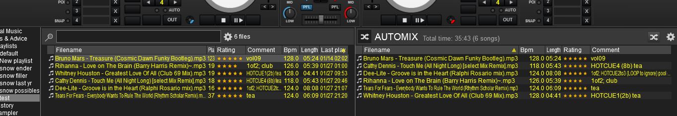

The issue appears to be this....The Automix pane had a few tracks added. I then 'clicked' on the Filename column and the Automix list sorted perfectly (screen pic right). I then saved the list as Test. When "Test" is later brought up (screen pic left), it brings in the saved tracks but not in the saved order.
Granted, anyone could then click a column to re-sort the list, but as I mentioned, I'm not wanting to return to a column sort after I have moved all the tracks around. It just needs to retrieve the list, exactly as it was saved, then the user can column-click if he desires.

In this particular example, I didn't even move them (at all - just a straightforward column-sort) and it got it wrong. See pic.
Additionally, if I were to move around the tracks and attempt a save, it still gets it wrong. Content only, no "order of appearance".
You appear to responding to me with "In Theory" responses. I appreciate your theoretical help (and I agree with you), but have you actually tried this, in real time?
I can't imagine our software behaving differently. My build is 3994.

I did try it, and it worked fine here.
In your screenshot, I do see a triangle in the Last Played column, so that's why the list is sorted by last played, and not in the order you stored it on.
If you right-click the last played column and select 'reset sort order', it doesn't change to the same order as the one you saved?

And there it is... It appears that if you make changes to the list WITHOUT turning off the arrow (up or down) in any column, the saved results won't necessarily be what you "see".
Tried it again, sorting by bpm (with arrow in place). TURNED OFF arrow by clicking to the left of the first field, then re-arrange files, and save.
List is saved as it appears!! :-)
Had no idea it worked like that, but it'll be easy to manage.
Thanks for pointing me in that direction.
