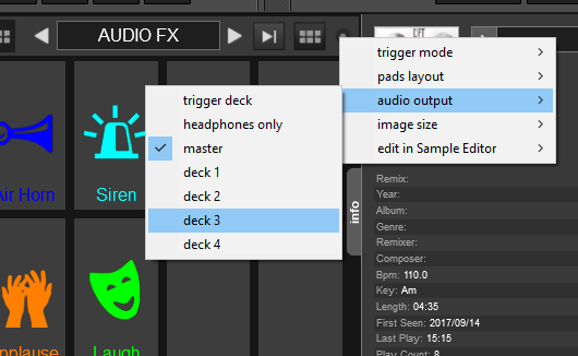

Sampler can be routed to Master, specific Deck or specific Sampler output.
When your Audio setup is set as Master & Headphones, Sampler is by default output through the same audio channels as the Master.
When your Audio setup is set as Ext Mixer (deck 1, deck 2, etc) then Sampler is output to all chans that the decks are using as output. If all channels volumes are down, sampler wont go out.
One way is to "sacrifice" a Mixer channel (actually a USB Audio interface pair of channels) and have it as the Sampler Output..In this case, if deck 4 is using out chansl 7,8, then you should replace that line with .. sampler (instead of deck 4)... sound-card... chans 7.8
Which of the 2 operation modes are you using http://www.virtualdj.com/manuals/hardware/americanaudio/19mxr/installation.html ?
In "Mixer" mode (with ext mixer setup), unfortunately, you dont have a spare pair of channels to use, as the Audio Interface only provides 2 outputs (for deck 1 and deck 2), leaving the other 2 Mixer channels to be used from ext sources.
Solution : Its only the "Controller" mode that can be used in your case and probably assign one of the decks to be your Sampler Output .. like this...
.. and control the Sampler Volume with the Mixer fader of the Deck that you 've chosen above.
