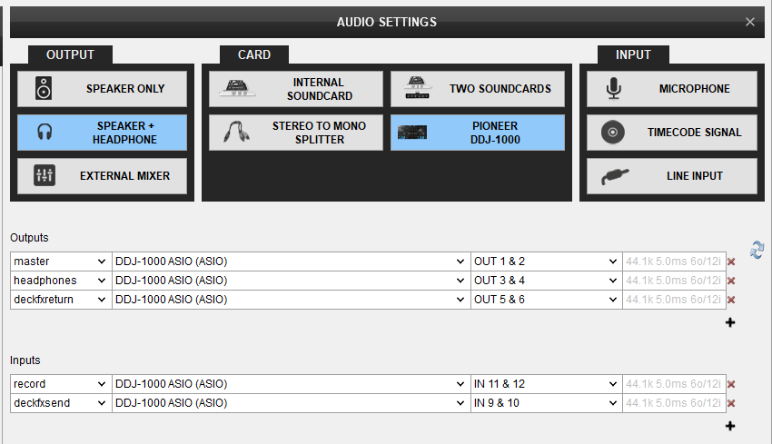

When u click the special button in the Audio Setup or the "Use Sound card" button on the Detection window, one of the inputs is incorrectly assigned to different channels. Please manually correct the deckfxsend to Chans 9.10 as per the following image
Inputs 1,2 | 3,4 | 5,6 | 7,8 can be used for Timecode or linein inputs.

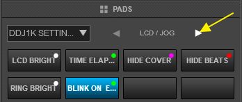

There is also a special DDJ-1K Settings Pad page included, which can be selected from the Pad pages drop-down list , and holds some useful settings for unit.
