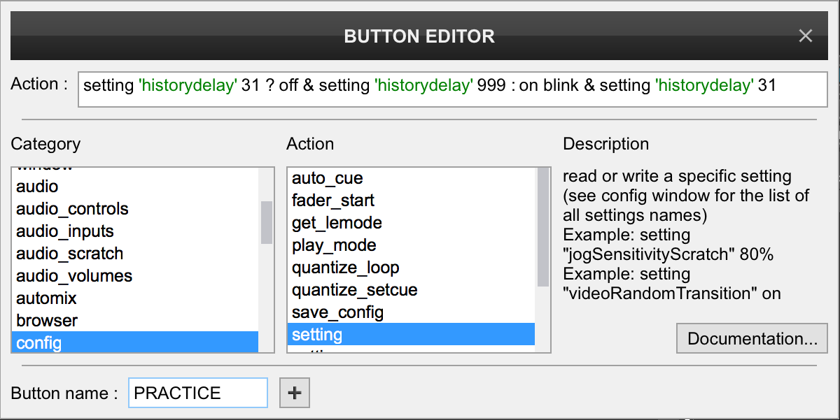

Setting database to read only isn't the best option for me. I still want to be able to set cue points etc. Looking like setting the history delay to 999 seconds (about 16 minutes) then returning to 31 when it's show time is probably best option for me.
Posted Wed 21 Feb 18 @ 2:26 pm
Use this script on a custom button then:
setting 'historydelay' 31 ? off & setting 'historydelay' 999 : on blink & setting 'historydelay' 31
While "practicing" the button will blink. Therefore it should catch your eye if you start the program for a normal gig and it's still set at 999 seconds

Thank you for this.

It's not toggling for me. It's blinking like it should as it's currently set to 999, and it stops blinking when I manually set it to 31, but pressing or clicking the button doesn't toggle the value nor change it from blinking to solid.

I'm using V8 but by Fruit skin. Haven't tested on any other skin. Would the skin matter?

Works in default skin but not V8 but by Fruit.
I left the setting at 31 and switched back to Fruit. The button was not blinking. When I pressed it, it started blinking and the setting changed to 999, but it would not toggle back off and change back to 31.

Ok here's what I found. There are 2 sets of custom buttons on the skin: for each deck, there's 4 on the deck, then 8 on the sidebar outside the deck. I had originally mapped the custom button IN the deck, which maps the button in the deck and to the button on the sidebar outside the deck. The button on the deck didn't work properly. I did not try the button outside the deck until later. That button works as intended, and the button on the deck follows the action of the button outside the deck, so the problem is with the skin, not the script. Before I contact Fruit, anyone want to take a shot at why only the button IN the deck doesn't work but the sidebar button does?
