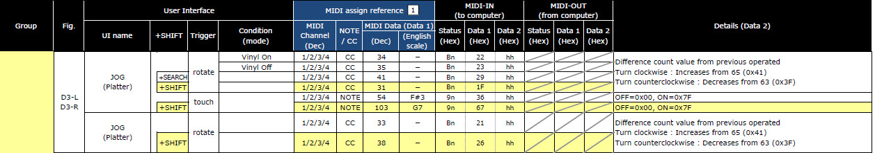

With the same way, you will need to define the other CC the jog sends. As far as i can see the jog sends different CC when in Vinyl mode, different when not and different when using the outer part. Define all of them as above (using probably different names) and map them all as "touchwheel" for the jog and "touchwheel_touch" for the TOUCH MIDI note
