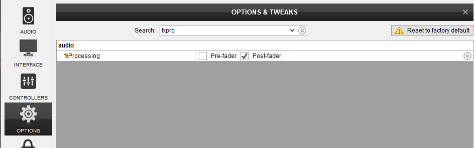

How would I go about key binding the echo effect to my track fader.?? So I could get that echo effect when I turn down the volume all the way, for a transition out?? I have the Gemini g2v controller btw.

You dont need any script to enable Post Fader FX method. Just a setting toggle as per the image below
