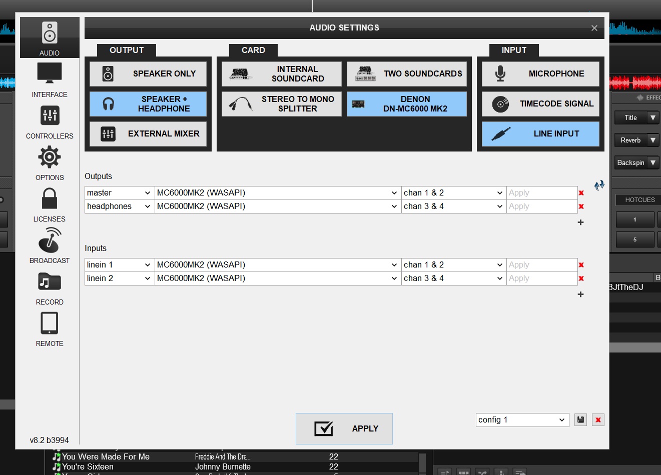

If you mean the "sounds" from VDJ (the PFL and the master) is getting send to your laptop speakers, then please post a screenshot of your audio setup screen in VDJ

BTW, can you post here a screenshot of your Audio Setup ?

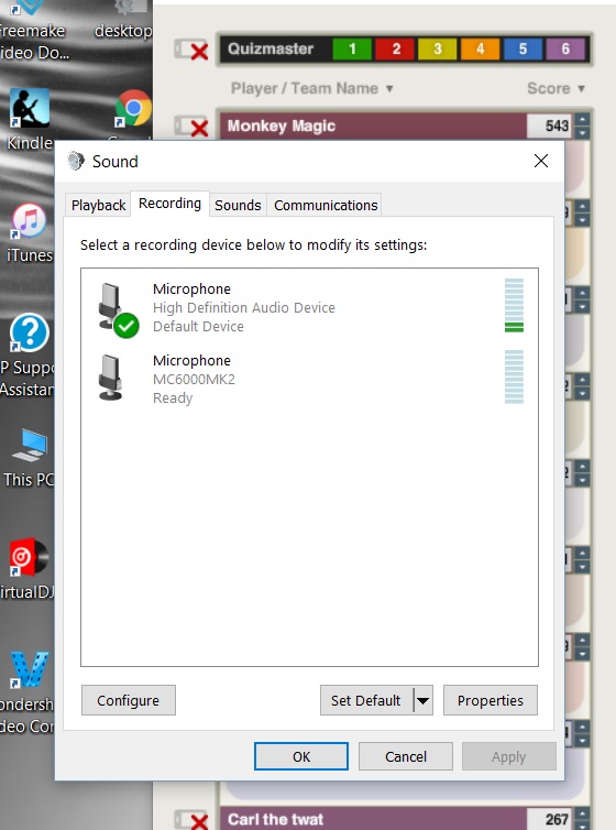

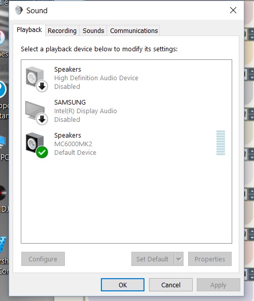

Please also look at the Windows Sound Config , where the default Playback and Recording devices are set. Which devices are selected when both Denon and HDMI are connected ?
