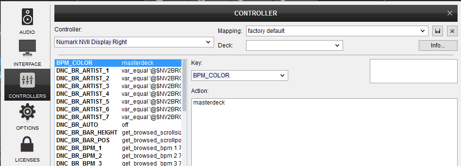

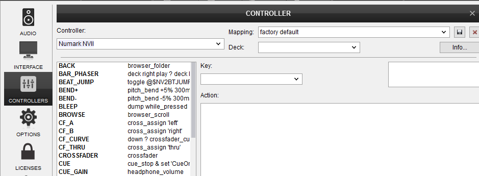

Yes, in most case you can change the functiality from the default to something else that you prefer.
Most of it is is mapped in VDJ (maybe not all of the screen), and you can change the mapping by replacing the current VDJ script with other VDJ script
You do this in the controller pane in the setting (screenshots below)
If you need help with the scripting, there are a few experts on this forum that can probably help you

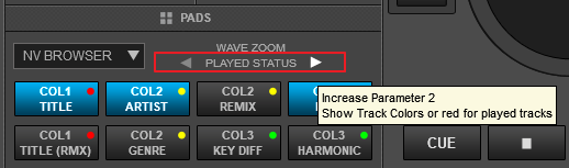

Feature 1...
The default mapping of the NV is not offering the played status, but the color that each track is assigned to (from Tag Editor).
Will update the default mapping (in next Build, whenever that comes) to offer the ability to choose from either showing the tracks colors or the played status, but in the meantime you can do the following...

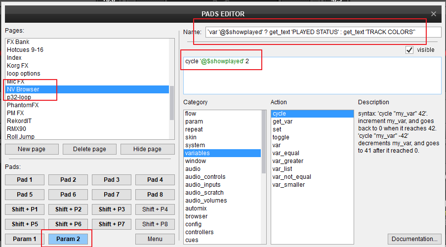

A. Update the NV BROWSER Pad page..
- Open the Pad Editor (from the Pads select drop down, choose "Edit" from the top of the list), select the NV BROWSER page and then click on the PARAM2 button.
- On the right side put as Text ...... `var '@$showplayed' ? get_text 'PLAYED STATUS' : get_text 'TRACK COLORS'`
and as action put .... cycle '@$showplayed' 2
B. You also need to edit multiple lines in the mapping for both Left and Right Displays, but to save you time and efforts, ...
- Download this file... https://www.dropbox.com/s/l2cw82j9tnof4yv/Numark%20NV%20Color%20Mappings.zip?dl=0
- Unzip the file into the Documents/VirtualDJ/Mappers folder (there will be 2 files in there)
- Open VDJ and from Controllers tab of Settings, select the Color Mapping for both Left and RIght NV Displays
If you do steps A and B, you will now see a 2nd Parameter in the NV BROWSER Pad page and you can choose if you want the colors to follow the played status or get the track colors.
Note. The firmware of the NV doesnt offer icons in the Files view, so we cant combine both the played status and the tracks colors. We only have the ability to change the color of each line, so if we combine both, a track could have assigned to red color and you would be confused if see a track as red and not knowing if its played or assigned as red.
