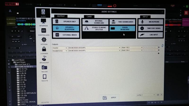

Can you show me what your settings are in VDJ* config? I'm using Ch. 2&3 using the fader. When I hit play on Ch. 3 I hear ch.3 when the fader is on Ch.2 or Ch.3. Ch.2 works fine, when I fade to Ch.3 I hear nothing.
My CF Mode is on Video & the MC6000 is configured like below. .
