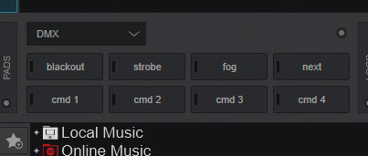

You can easily add "pads" support to any program that accepts MIDI in/out
Here's an example for another program: http://www.virtualdj.com/forums/218737/VirtualDJ_Plugins/The_Advanced_Freestyler_integration_thread.html
This method can be used with any program (it needs to be adopted of course) and for a simple task such as mapping 8 buttons you should be up and running in 15 minutes

4 - Any luck with pad support as I have the MCX8000 and it would be easier than buying another controller.

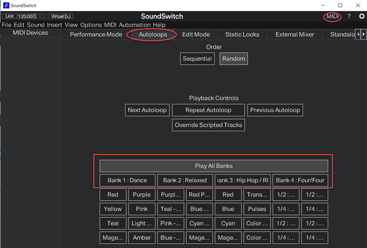

Hey kradcliffe!

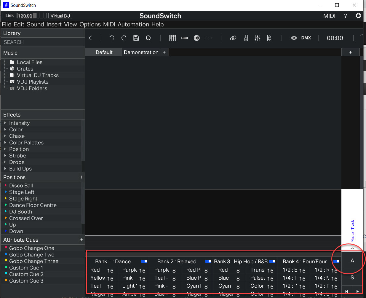

1. You have to manually go through and create a script for each track. If there is no custom script created, then it will pull from your "Autoloops".
You have to select one of these 5 options [below] to tell it what Autoloop bank to play from or use the default "Play All Banks". These will run only in the absence of a custom/auto script or if you press a MIDI Autoloop button and have the "Override Scripted Tracks" option selected (I'm pretty sure I am correct on that last part.).
The good news is that you can create a custom show for multiple tracks at one time. SS currently does not allow you to select a whole Windows Folder, but you can create a playlist of Virtual folder, open it up in SS, select all of the tracks, RIGHT-CLICK your mouse and select "Autoscript Selected Tracks". You can tweak the parameters before it auto-creates the shows/scripts. Then after it creates them, you can completely customize any of them. You can create a show from scratch without first using the "Autoscript" feature first for that matter.
2. Yes, you can override a scripted show by using an "Autoloop and/or a "Static Look". While in Performance Mode you go to the MIDI section and select an Autoloop or Static Look. It sounds like the Static Look is what you are needing for precise control of moving heads, etc. I can't remember, but it seems that the rest of your sown will pull from the script or autoloop, but whatever you setup in one of your "Static Looks" will change. So the show will be the same except all of a sudden the moving lights all aim towards the center of the dance floor, because you pressed the button you programmed labeled "Center", for instance.

4. I think this is on their radar, but not sure when. The ideal would be to map SS to VDJ soft buttons. Whatever controller you would use would be irrelevant at that point.
