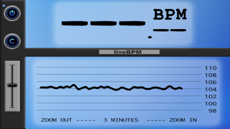

Sorry groovindj I forgot to say what song it was. It was Hit me with your rhythm stick by Ian Dury & the Blockheads.
Posted Sat 09 Dec 17 @ 9:27 am
Some DAW software does offer a similar function (i.e. Cubase) but Ableton's software is the one most associated with the process, probably because IME it's the easiest to use.
[later] Just found an iPhone app that measures real time BPM and creates a graph...
![](/img/249912/41805/rhythmstick.png)
The tempo wobbles around a little bit but is roughly 104.
@Adion why can't we have something like this in VDJ?
Posted Sat 09 Dec 17 @ 9:30 am

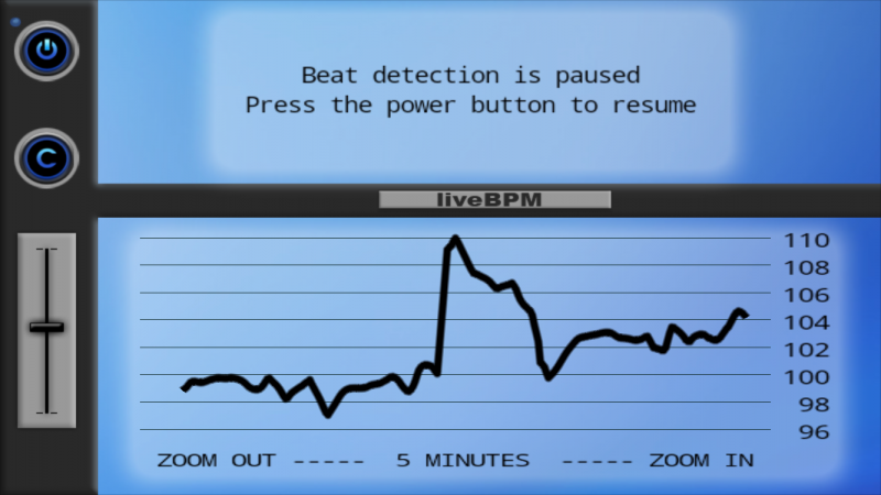

Here's what Radar Love looks like on the graph...
![](/img/249979/32292/radarlove.png)
One big jump in the middle section.
I'm wondering if dropping that section back down to the 'main' tempo will impact on the feel. Might stand out like a sore thumb.
Posted Sun 10 Dec 17 @ 9:04 am

Ha Ha ha, that makes it look even worse than I thought!
The drummer is hopeless every time he does a fill he looses the beat, and other times he just drifts around it. or away from it.
groovindj said, "I'm wondering if dropping that section back down to the 'main' tempo will impact on the feel. Might stand out like a sore thumb".
Possibly, but only one way to find out.
May end up being one song I'll try not to use, or if I do, it will have to be as is, without effects.
Posted Sun 10 Dec 17 @ 10:17 pm
