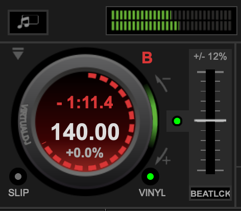

Bit of distortion or something on the button top left.
Also is it not possible to have BEATLCK as a button shown like this:
BEAT
LOCK
Posted Sat 28 Sep 19 @ 10:38 pm
Posted Sat 28 Sep 19 @ 10:39 pm
What's distorted? That button has always had the same icon (quavers and rectangle).
Posted Sun 29 Sep 19 @ 7:37 am
You can see there is a square inside the button.
Posted Sun 29 Sep 19 @ 6:45 pm
That's a rectangle - and like I said, that's the design of the icon.
Posted Sun 29 Sep 19 @ 7:13 pm
