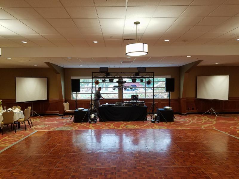

Ok so last night I had a wedding reception to do and the venue wouldn't let me use a fog machine due to it possibly setting off the fire detectors.
So my question is, what can I use in place of a fog machine when I'm not able to use it at certain venues??
We all know the lights and lasers look better with a little bit of fog, lol!!
A picture while I was setting up.

@ the SOUND INSURGENT
Do like your setup (pic)

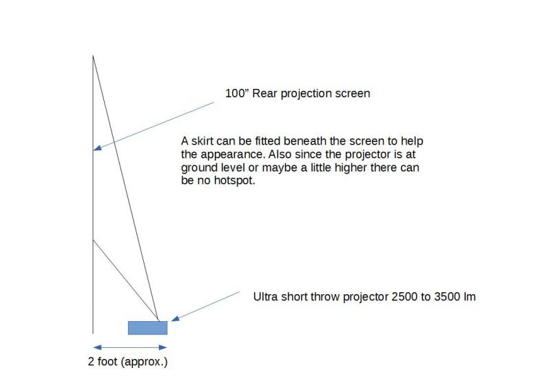

Beatbreaker I don't know your layout for smaller venues but this is my smaller venue layout then I drop down to a 42" tv. It may help.
A school or boardroom ultra short throw projector is fine since all the videos at the likes of Extendamix are 720i. Therefore a 1200 x 800 resolution is fine. 1080i is still not really needed.
