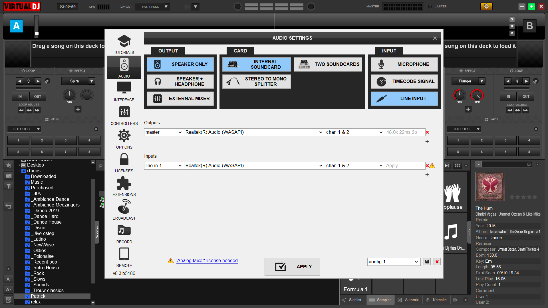

Your audioConfig might be wrong, show us a picture

try removing the line input :-)

You probably want this, or the wasapi equivalent.
That was the original state, and did not work.
I first thought the Hercules could be considered to be input...
Posted Sun 15 Sep 19 @ 7:44 am
I guess that this is indeed what I want.
I assume I need to take some action somewhere to have the Hercules Control Steel added to the "card" section...
I will try to keep on looking for a solution, but thanks for any tips and suggestions.

Yup that would be drivers

The Steel has no audio interface, inputs or outputs, so will not appear in the 'card' section of VDJ.
https://support.hercules.com/product/djcontrolinstinctp8
I noticed that for some reason my drivers were not properly installed.
Because I got no notification during/after install yesterday, I did not pay attention (tunnel vision, as you assume that step is correct)
So just uninstalled it, and installed it again, and it is working now.
Thanks all for the support.
Posted Sun 15 Sep 19 @ 8:27 am
where did I get P8 from? *kicks at floor, falls over*
