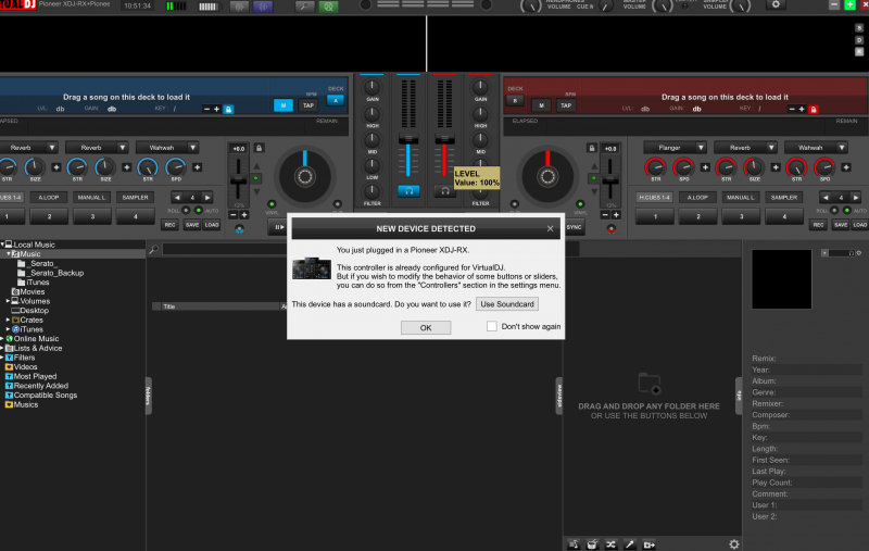

Looking for any advice as this is driving me insane. I recently bought a new Pioneer XDJ-RX and having issues having VDJ recognizing the controller to config the sound. My other controller, DDJ-SB has no issues.
First when I connect the XDJ-RX, VDJ does recognize and asks me if I want to use the internal soundcard for it. I select yes. I can load tracks, operate the software, etc BUT when I tgry to config the sound as I want to play on external powered speakers connected to the controller, it doesn't give me any audio options to select the controller, not even the pre-configured audio button appears for it. Here is some of the specs I am using:
-MacBook Pro (newest model w USB C only) - running OS 10.13 (driver has been installed from Pioneer)
- Firmware on XDJ-RX has been updated to 2.20
- tried connecting with both a USB B to USB C adapter directly to laptop and using the original USB B to USB A (original cord) to a USB C adapter on my MacBook Pro.
- Current version of VDJ 8.2
See images. Showing it does recognize and another showing the audio settings where it doesnt allow me to config the audio.
Any help is greatly appreciated.

OK so when the box pops up saying it's detected the RX, what happens when you click the 'use soundcard' option?
That should be enough. Once you've clicked that, there's no need to config the audio yourself or change the settings.

have you installed the mac audio drivers?
they can be found here https://www.pioneerdj.com/en/support/software/xdj-rx/
also it appears the driver doesn't support 10.13 yet .. best to check this stuff before any purchase or OS upgrades

Thanks guys... problem solved. The drivers for the XDJ-RX are not compatible with MacOS 10.13 at this time. I reverted back to OS 10.12 and all is good! Thanks for the responses.
