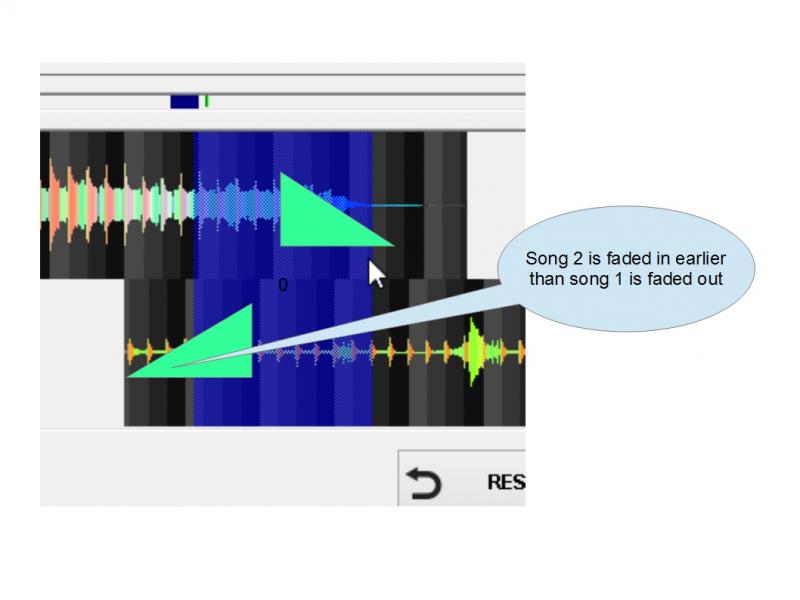

I am doing a bit around with automix editor at the moment.

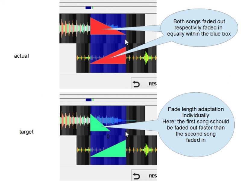

What I'm missing is the possibility to editing the fade length of each song individually. I tried to make a picture for better understanding. I hope everybody will get it what i mean.

Think about what the output level will do in each case...
With the red fade, the output will stay even because when track A is (e.g.) 50% down, track B will be 50% up. They're fading at the same rate.
With your green example, track A is fading out much faster (maybe x2) so by the time it's at 50%, track B will be barely audible. You'll get a quiet spot / dip in level.

Thank you for your response.
Maybe you are right. But what if i want it the opposite way: Song 2 and song 1 schould be heard together.
Like this way:

This is very similar to what I'm looking for, song 1 to start playing at full volume while song 2 gradually fades out to it's end.

That is already possible. Please check the automix fade options.
http://www.virtualdj.com/manuals/virtualdj8/interface/browser/sideview/automix.html
