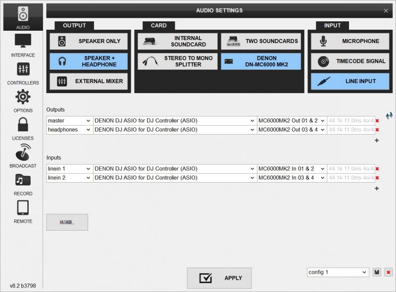

Just checked my bootcamped PC version (normally run the Mac version). My settings are the same as yours above.
Click on the ASIO box bottom left, it will show your ASIO settings.
The top line on mine reads;
DENON DJ ASIO for DJ Controller Ver. 1.0.1
You have to be careful with Denon DJ Drivers as there was a different driver for the MKI.
P.S. I also have Denon DJ ASIO 2.2.2 on my system, but, it's using 1.0.1 and working.

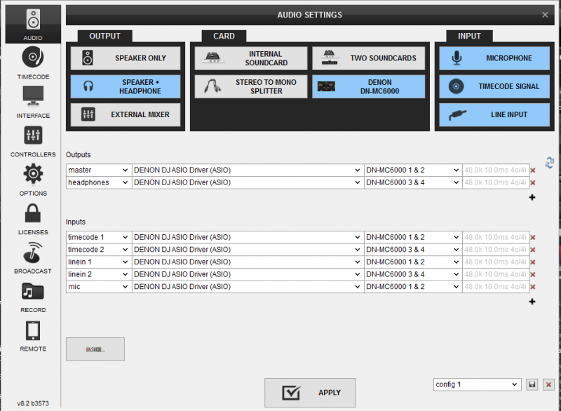

I'm still using Ver 8.2 b3573 any later and i get Clipping in audio here are my setting I'm using a DN-MC6000
Hope this helps you.

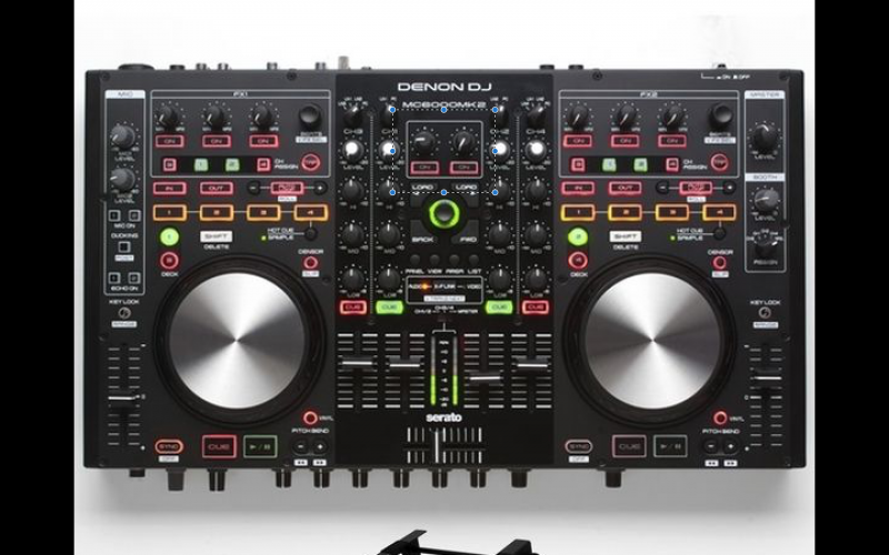

Check your "Filter Knobs" You'll find them right underneath the Denon branding at the top of the controller.
They should be at 12:00
In the picture they are in the activate Wet/Dry potions to show how the lights turn on when the filter is activated. The light should be off during normal operation.
Consider joining the Facbook group "Denon MC User Group. https://www.facebook.com/groups/204684416346731/
