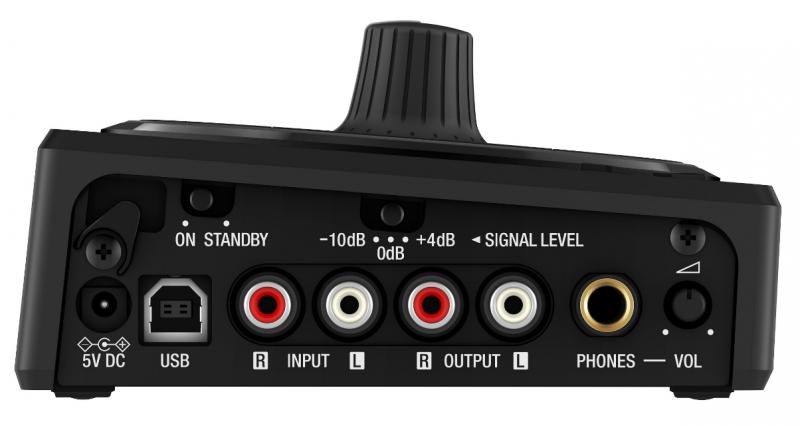

if i purchased a rmx 500 and plugged it into lets say line 3 with on my denon, will the more echoey, whooshy effects come through properly when using it to mix in vdj 8.2? im not looking to add drum beats or the like. so it doesnt need to be timed with the beats.

I think it would be a shame to use it that way. You need an audio output from your system to be linked to the rmx500s input to take advantage of it's features
But I guess for white noise and a few other things that don't add to the music, but actually generates sound, it may work
You can test what it would sound like if it works pretty easily I think
Go to youtube and grab (download as mp3) a few examples of the effects the rmx can make without input (like white noise, I guess), load them on your phone (or another player/laptop), and attach that to the mc6000 input. Then you'll get a good idea about what it will sound like
But normally you'd insert the rmx500 between the master out and you PA, or in an effect send/return loop on a mixer, so that you send audio to it's input and get it back again from it's output:

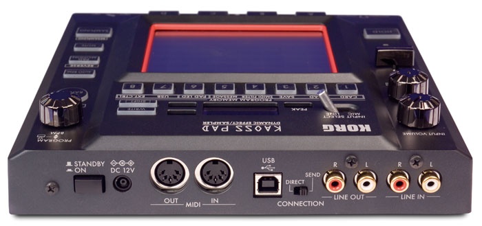

ok it might work. but just not the way i mentioned. maybe a korg kaos pas would be better

It's the same thing. To get something out of it, you need to put it after your controller, so that it gets the audio output from the controller into it's input, and then after applying effects, sends the output including the audio from the song to your PA (or whatever is next in your setup)

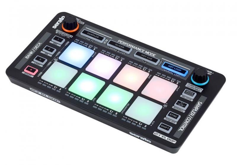

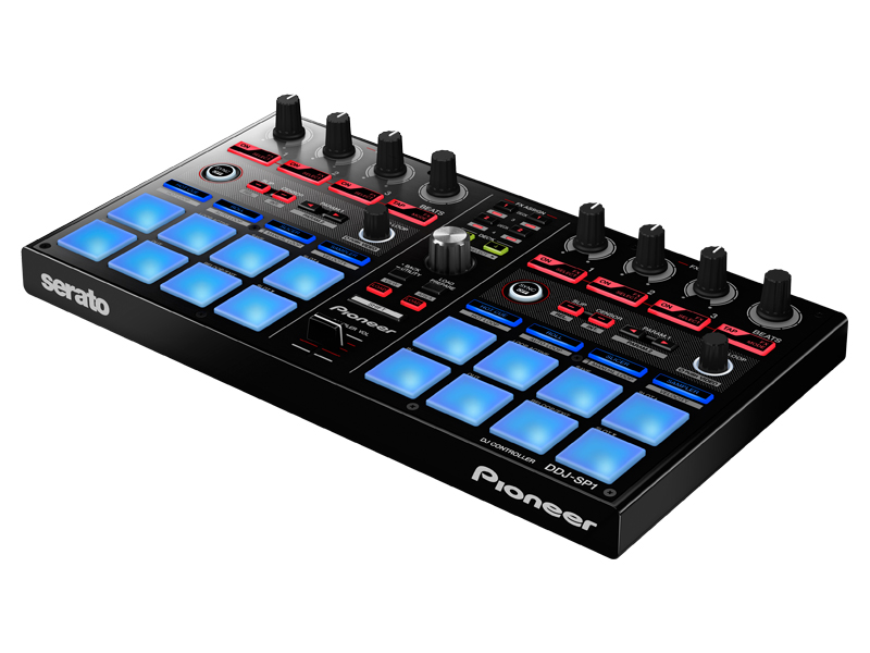

If you don't want that, and feel that you have too little control over your internal VDJ effects using the MC6000, you can add a second MIDI controller specifically for controlling the VDJ effects. Like a Pioneer DDJ-SP1 or a Reloop Neon (which you can both use as-is, or re-map to your liking). Those will just need a second USB port to start controlling VDJ together with your MC6000
Posted Mon 14 Aug 17 @ 3:23 pm
that pioneer thing looks great. thank you so much. does it have a mapping for vdj. im not good at midi mapping
so im checking out the ddj-sp1 and it says it works with vdj8. so i can use this along side my denon mc6000? and i want whatever sounds that come from it to be included in the mix. so that the recording i upload to soundcloud has it.
dumb question. can you even have 2 controllers setup with vdj8 at the same time. this pioneer thing looks like you can control decks and such. i just want the efffets.
just bought the pioneer. should be fun. thanks again for your input

This is the manual for DDJ-SP1.
https://www.virtualdj.com/manuals/hardware/pioneer/ddjsp1/index.html

I used the SP1 along with MC6000 and it's a great combination. Only sold the SP1 when I got the MCX8000 as it has pad support built in.
They both work well together, highly recommended.
