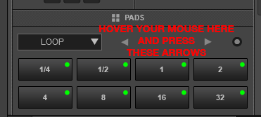

You should NOT EDIT the pad page.
You should NOT OPEN THE PAD PAGE EDITOR at all.
Just start VirtualDj, select the loop pad page on each deck, hover your mouse on the red area of the previous photo to see the arrows, and click on them until the values you see on screen match your preferences.
Posted Tue 11 Jul 17 @ 9:17 pm
