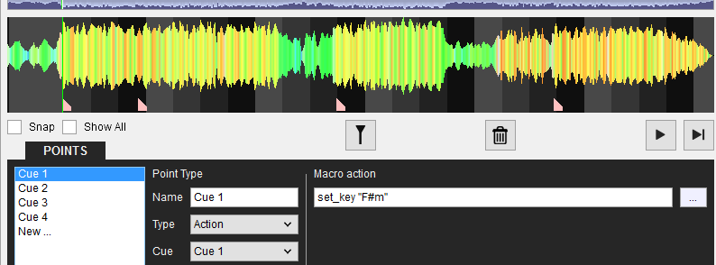

The only way to do that is to create a Hotcue 1 (if doesnt exist) and change it to Action type and then use the set_key verb.
You also need to have the setting autoCue to "Cue"

It took me a while to decipher how to implement the suggestion, but I made it, and it works great. Thanks again.
