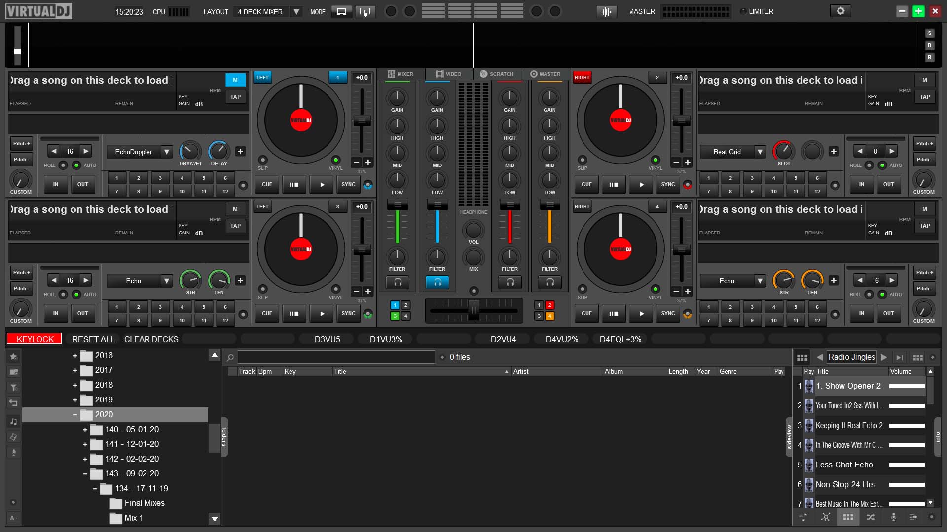

if i can give you a suggestion, forget the knobs for now and try vdj8out on 4 decks vertical 3124 AND EVERYTHING WILL BE A LOT EASIER TRY IT YOU WILL SEE? WORKED GOOD FOR ME SO

Thanks for you reaction, but that doesn't actually answer my question. What do you mean by 'download the skin' ? (I have all the standard (default) skins that came with the installation of VDJ8).
And why should I use the 4 deck-skin if I don't need 4 decks to do 'my business' ?
I want to work with the 2 deck layout (and in the 4 deck layout I also only have 3 buttons and 1 knob). In the tutorial video's I mentioned, they also work with 2 deck layout (with apparently 4 custom buttons, 1 knob and a 'Vinyl' and 'Slip' button).
