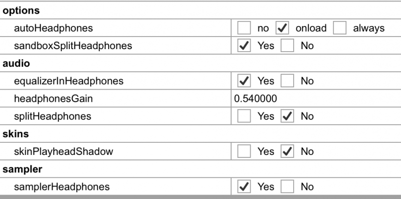

I have a new Pioneer DDJ-SX2 and for some reason I am unable to get the headphone cue working. I can turn the headphone mix to master and hear the master output with no problem. when I push the CUE button on the controller it reads on VDJ 8.2 b3696 and lights up the button on Virtual DJ software. Has anyone experienced this with the DDJ-SX2 before?

.....and your audio config in VDJ is...?

With SX2 connected you should NOT use the software headphone controls (the ones on VirtualDj skin/GUI) to control your headphones output.
Instead you should use the controls on the controller itself.
So:
On SX2 turn the "Headphones Mixing" (14) knob all the way to the left.
Use the PFL (4) buttons to prelisten the tracks.
In order to prelisten the master output, press the "Master PFL" (15) button and then turn the "Headphones Mixing" (14) knob all the way to the right

check your split also.
