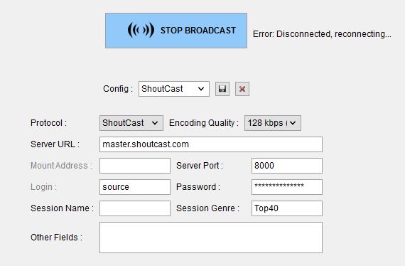

So I am trying to connect to a Shoutcast server and having zero luck. I have opened the port and verified the port is open. All the login information is correct as it connects for about half a second and then immediately disconnects and attempts to reconnect with no luck. Has anyone had this issue? I have run Virtual DJ 8.2 with both admin priv and without; both coming up with the same outcome. I attached an image below of the error I am receiving.
Has anyone had this issue? I am on VDJ 8.2 b3731.
Thanks

Thanks for quick reply.
I am running on Windows 7, all updates have been installed. This is the first time I have used Virtual DJ for broadcasting, I typically used SAM Broadcaster but decided to try a new platform, especially with the content unlimited that is provided for a small monthly payment. I have two "servers" for the station. One being hosted by Shoutcast themselves on their Master server and I also have a server on my computer; neither are connecting via Virtual DJ.
I have connected to both on SAMBC and works just fine; it is a Virtual DJ issue and not sure if Virtual DJ supports Shoutcast v2?

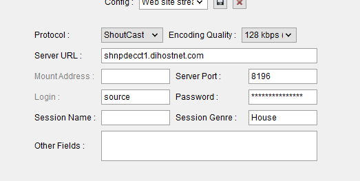

yes mine connects fine on shoutcast v2
here is what my config looks like maybe of some help to you

Here is my setup, identical to yours but still having that immediate disconnect issue that I don't have in SAM Broadcaster:
Posted Sat 13 May 17 @ 9:36 pm

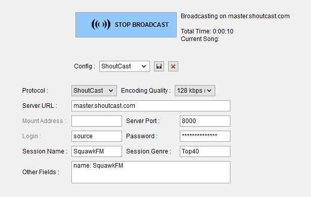

So I messed around a little bit with a few items and finally got it to work but had to do a few different things:
Posted Sat 13 May 17 @ 9:45 pm
