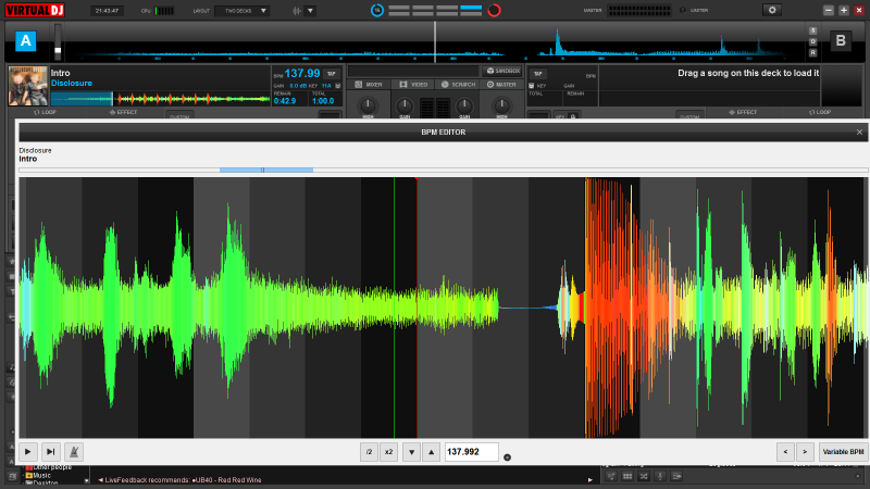

@Adion:
My apologies as a lot of the tracks in that list were changing post analysis. They were analysed in an earlier build of V8 I think (I didn't have V7 installed on PC and I didn't migrate settings so it wasn't that). The following tracks are specific examples which are post-re-analysis where not mentioned.
Note that almost all of those tracks are out by the 3-15 thousandths that puts a 7 minute track audibly off by the end of the track. I'm guessing you don't want to fix this issue? I would very much like to see a solution but for now it is a lower priority. Would you accept a separate thread about it when you are happy with the resolution to unsyncability?

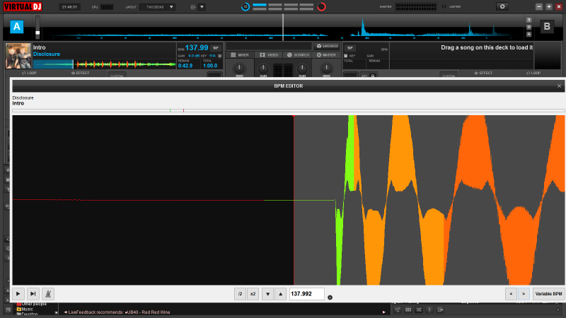

Intro by Disclosure:
Initially a little out, but still detecting silence as the start of the beat.
I fiddled, then pressed "analyze BPM" to re-set to default and got this:
Clearly off by three beats. Not sure what is happening here - not the first time this has happened.

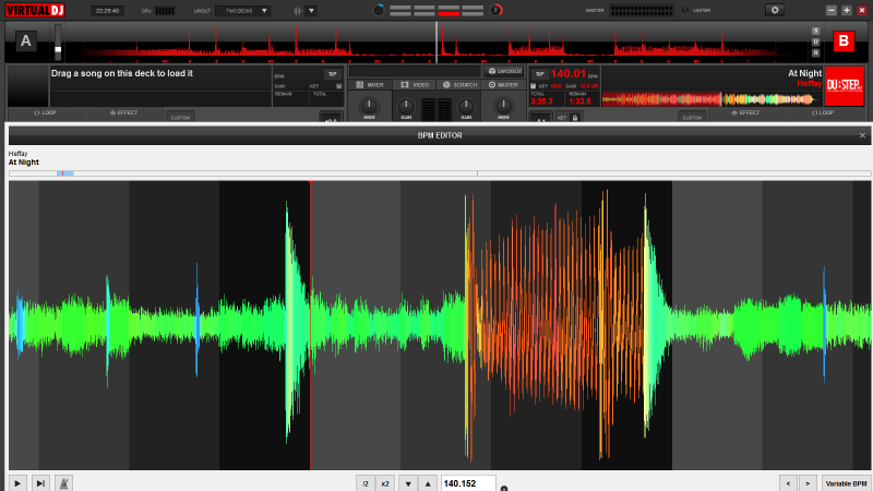

Heffay - At Night
Phase ok, phrase out.

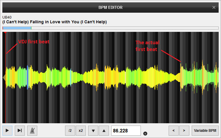

"Jane, stop this crazy thing". You guys are going to make me slit my wrist. The UB40 song is 86.15 to 86.23 BPM (I have 2 versions, one is a remix). The first beat is where he starts to sing. Just because you don't hear a beat, does not mean it's not there. I mix this track from the beginning of where he first starts to sing, with any track that is in the range. Maybe this just comes natural to me, because I do not see the issue here.

AMAHM, wouldn't the first beat determine where the mix should start when in automix?
When the UB40 song is in automix, it seems to ignore the VDJ calculated first beat position and do the right thing so confused. To me I would not start dancing until what I think the first real beat is and not when the guy is initially singing. Maybe you could shed some light on this for me.
