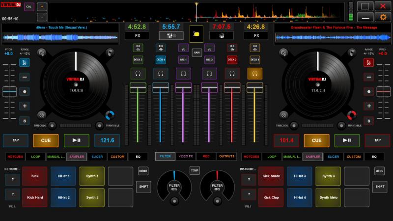

Decided to use your multi touch skin as a base for a 4 deck version with 2 mic's routed permanently to 2 decks aswell, to gain use of effects on them.
Also needed all faders for the deck to been shown, no matter what deck is in focus.
So basicly fiddling around with some buttons and other stuff to re-position things to make room, without loosing to much
