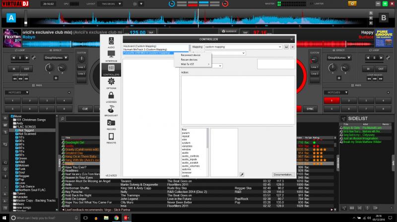

Ok. I am trying to figure out how to output the midi clock from VDJ to hardware. Specifically the Korg Volca Beats. I have found a few threads about using loopbe to send to another software, but not to hardware. The Korg has a sync in which looks to be a 1/8 TRS jack input. So what do i output from the laptop? There is a midi input too, though the manual says this is just for controlling by midi controller. My audio interface has midi in and out too. I cant find an option in VDJ to output the clock? If anyone can help, would be much appreciated.

Thanks Locodog, but the Korg doesnt show up in the list because its not connected to the laptop. The only way i think i could connect it would be to use a midi between my audio interface and the midi on the Korg. But the Korg manual says that the midi sync has to come in on the jack.

have you tried to right click the controller you have connected or the keyboard .. just a suggestion
the korg will never show in the list you need to send via what is on the list to the korg

Yeah, i can right click on them and I have the option to output midi clock, but what would be the point of sending the clock my controller? I need to send it to the Korg dont i? I am a bit new to this midi lark as you might have guessed.

The focusrite shows in the list, just doesnt have the option to output midi clock to it. Bizarely, I just went to take a screen shot and the option was there, but then came out of options and back in and its gone again. Think a USB midi cable might be easier. I did have a look on the focusrite website, thought maybe there would be a driver or something but couldnt find anything. The only utility with the interface is an asio control panel which allows me to change the sample rate and buffer size.

Just an update on this for anyone who might be trying to do the same thing. Midi cable from my audio interface to the Korg Midi in does not work. So I bought a USB to Midi interface cable. I was fairly sure this wouldn't work either, as from the Korg manual and online searches, the midi input on the Korg is only to control it from a midi controller. Anyhow, I did try.
VDJ recognised the USB cable and allowed me to export midi clock to it. The Korg did recognise it. With the Korg you have to change the global parameter to accept an external clock. This is done by powering off, then powering on with the function button held down, then selecting pad 6. You then have to restart VDJ and the Korg. Interestingly, this did now mean that whenever i pressed play in VDJ with either mouse or controller, it started the KORG in play mode. Which is cool, but doesn't keep tempo.
