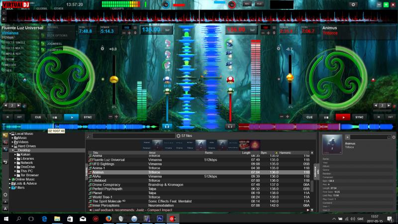

Oh jesus I was having fun with this all night LOL
Stripped off of anything I don't have use for, with some added visual aid.... :-D

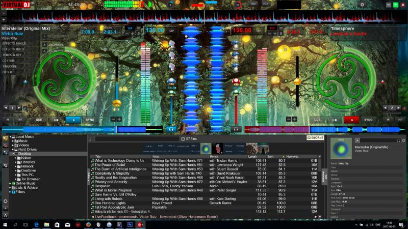

Even more far out :-D
Thanks djDad for this tool, great stuff :-)
