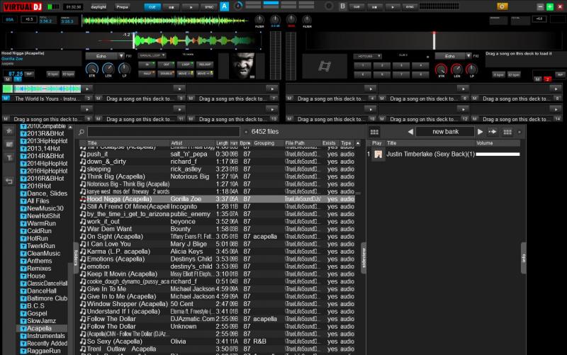

JMF and I are trying to tackle this function, as we work this hopefully we can get some help along the way to impement correctly.
Posted Sun 25 Dec 16 @ 4:47 am
!st demo, gotta fix browser bug and change the button a little. Gonna add a pad page to handle the commands
Posted Sun 25 Dec 16 @ 6:56 am

working on this, theres a lot to work out. Im trying to work on a pad page also. to be able to trigger the minidecks
