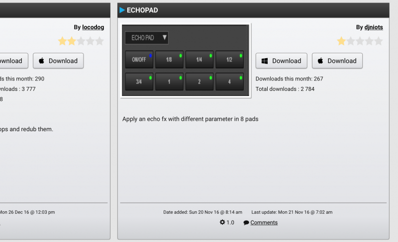

The ECHOPAD is LOUDER then the music when using ( the Volume louder then the Song ) is there a way to turn the volume down when using this FX ?

vinyl burns, when you use for the first time the echo you don't select the beat value only the on button and then you select the value. This is what you have to do only the first time, after this everything is ok. I will try to fix this as soon as possible.

asthedj+ this is because the volume of the echo has been adjusted by me to 80/100. if you want to have a lower volume you have to go to the pads and change the effect slider 1 to 60 or 70. I will try to modify the code and use the first two pads in order to adjust the volume of the echo.

I'd use param 1 to set a var from 0 to 100, and use that to set the echo strength via the pads.
I'd also make param2 set another var and use that to set the deck level (again via the pads) when the effect is called.

The pads use the regular echo effect with specific settings
So if you choose the Echo effect in the effects dropdown in the effect section, you can click the little "+" and get all settings for Echo
That looks something like this:
Only the strength and length settings are affected by the pads.
The rest you can change as you like, and that will work for all the pads
Also if you want the echo effect to keep echoing after you stop the track, try enabling post-fader effects in the settings, like this:

The dropdown is in the software :)
You only need it to go to the settings page by clicking the plus marked in red below:
