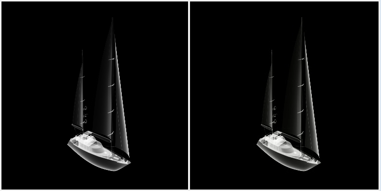

At first I was using the NDI Video Monitor tool they provide for testing. I could see right away that the colors and detail was off from the original video. I assume the NDI Video Monitor always converts to some YUV variant for display so not really a good test for possible quality. It is good enough for testing and that is about it. I wrote a sender and receiver to be sure about quality. In this case, both sender and receiver are using BGRA and not YUV and the receiver image is unchanged. The original image is on the left and receiver image is being displayed on the right and you can see the quality is good.

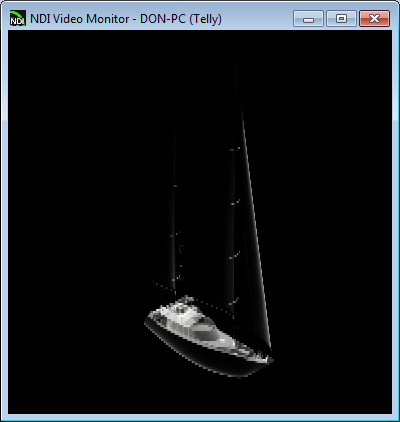

This is what it looks like in NDI Video Monitor tool. The sender from my sample app is sending the same image to both it's receiver and the NDI Video Monitor. You can see loss of detail. For colorful images you will see some loss of color. Trade off between the amount of network traffic and quality.
There could be some other things going as well with that.
