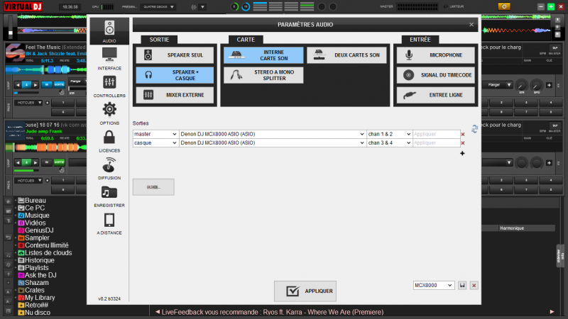

cue/pfl doesn't work. When pressed it lights up but I can't hear the track playing in my headphones unless I increase the volume slider. This is true whether it's on L,R or Thru.
Posted Sat 30 Jul 16 @ 2:41 pm
Hmm maybe you have the CUE/MIX knob to the MIX position and your Headphones get the MAster Output ??
If that is not the case, then please post here a screenshot of the Audio configuration (from VirtualDJ settings)
