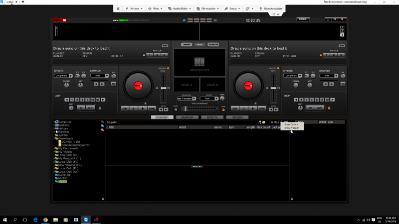

I lost show music, video and karaoke options. I tried a repair but that didn't work. Any help please? This never happened in the past. I've been running 7 on this computer for 5 years without a glitch

Yes I tried reinstalling, repairing nothing worked... I just figured it out last night. By clicking one button in "configure" you loose music, video and karaoke viewing options in the browser and that button is not in the "browser" options. Why would VDJ have done such a silly thing and no one could answer me since I posted it last weekend? This button has nothing to do with the browser!! I tried turning off everything in the free home version and thats how I discovered it. No matter which version of VDJ 7 you use it functions like this. Doesn't make any sense VDJ team!! Sure did screw my night up... Then waiting 4 days and ZERO help I got desperate and tried every possibility.

No I didn't make it clear on purpose as I was upset not getting a response from the team in 4 days. Open config., click video tab, click enable/ disable video engine and see what happens. What does the browser have to do with the video engine?

It's sort of logical, because both Karaoke and Video need the video engine running to function. If the engine is switched off then there's no need to display those files in the browser.

Sorry its not logical in any sense... It also affected my mp3s!! I have 79,000 mp3s and it only displayed that there was only 139. When your working as a full time DJ in the same bar for 16 years at a busy time and this happens you need to think quick. No time for google dude. Thankfully I had just tested another software during the week and had scanned all my music. Why would VDJ put an enable/disable button for the video engine which would also effect the browser?? I was having problems with the video before it finally crashed. I use video 100% of the time but you can also play video without displaying it so where is the logic of the button hiding video files? Anyway I figured it out on my own time and thats what counts.

I left the door open for a logical reason, obviously if your not doing video or karaoke, mp3s should be just as they were with it enabled.
The reason its there is so djs doing audio only with less powerful computers can shut the engine down and conserve cpu power.
Maybe this was a carry over from the weak pc days where we had so many stuttering and latency issues.
As you know, video djs have always had higher pc requirements, so it does make sense to me I guess.
