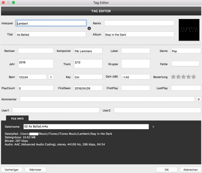

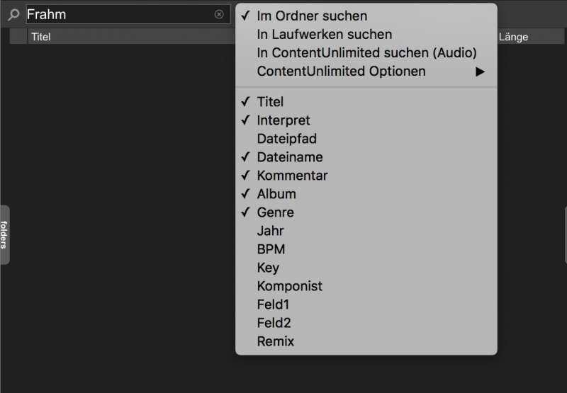

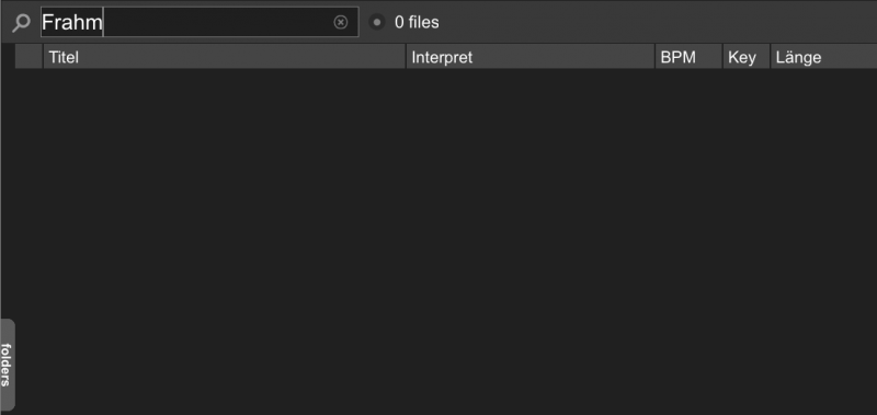

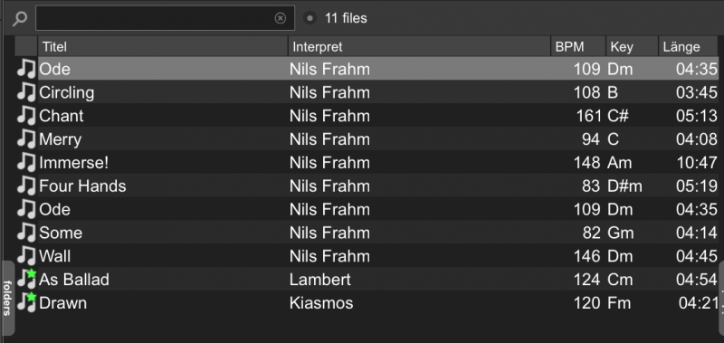

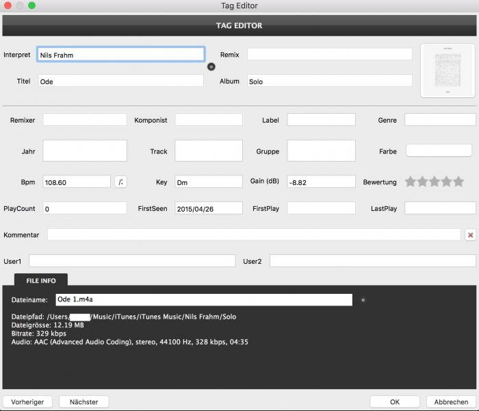

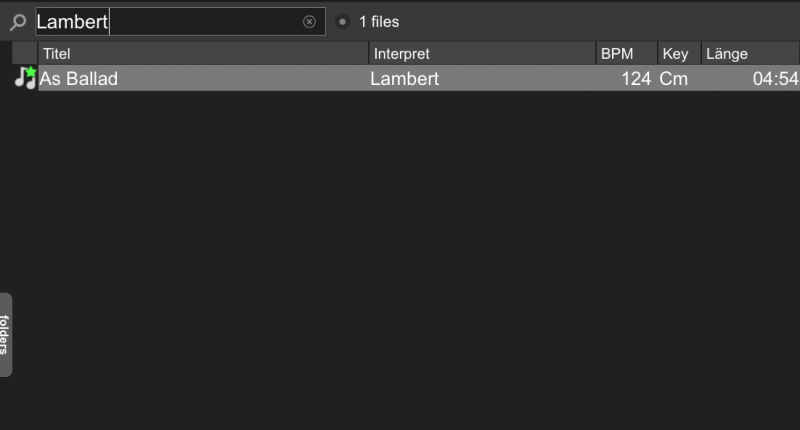

I made some screenshots to explain. Although the tracks from the artist "Nils Frahm" are all in the playlist, searching for the artist name does not show a result. Checking with another song from "Lambert" works fine. You can also see that the search settings are fine. The songs are all AAC files, not protected. They all play fine.
I am using VDJ 8.1 build 2857 on Mac (El Capitan).

Hi Sound&Silence,
have you tried enabling the search in laufwerk?

Hi Raypitman,
yes I tried, no change. The songs dont show up. The only difference I find in the files are that they have a higher bitrate, but I doubt that that causes the problem, as they play fine in VDJ.
Also opening the track editor, changing something and saving again does not solve the problem.

ok, just noticed that Frahm is only in the pfad, not in the datei name ...
so enable search in dateipfad and try it all again ;-)

Doesnt work either.
